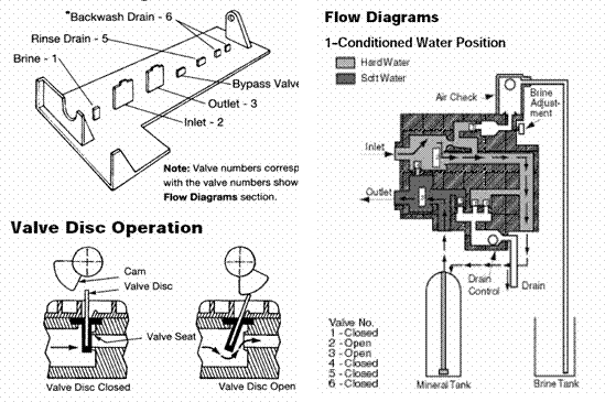

发表于 2007-3-30 15:19 | 显示全部楼层
278阀阀门阀板位置示意图见附图
#1 = Brine Valve (吸盐阀)                      #2 = Bypass Valve (旁通阀)
#3 = Inlet Valve (进水阀)                       #4 = Outlet Valve (出水阀)
#5 = Refill Valve (补水阀)                      #6 = Rinse Drain Valve (排水阀)
#7 = Backwash Drain Valve (反洗排水阀)
[ 本帖最后由 txbyxtjw 于 2007-3-30 15:37 编辑 ]

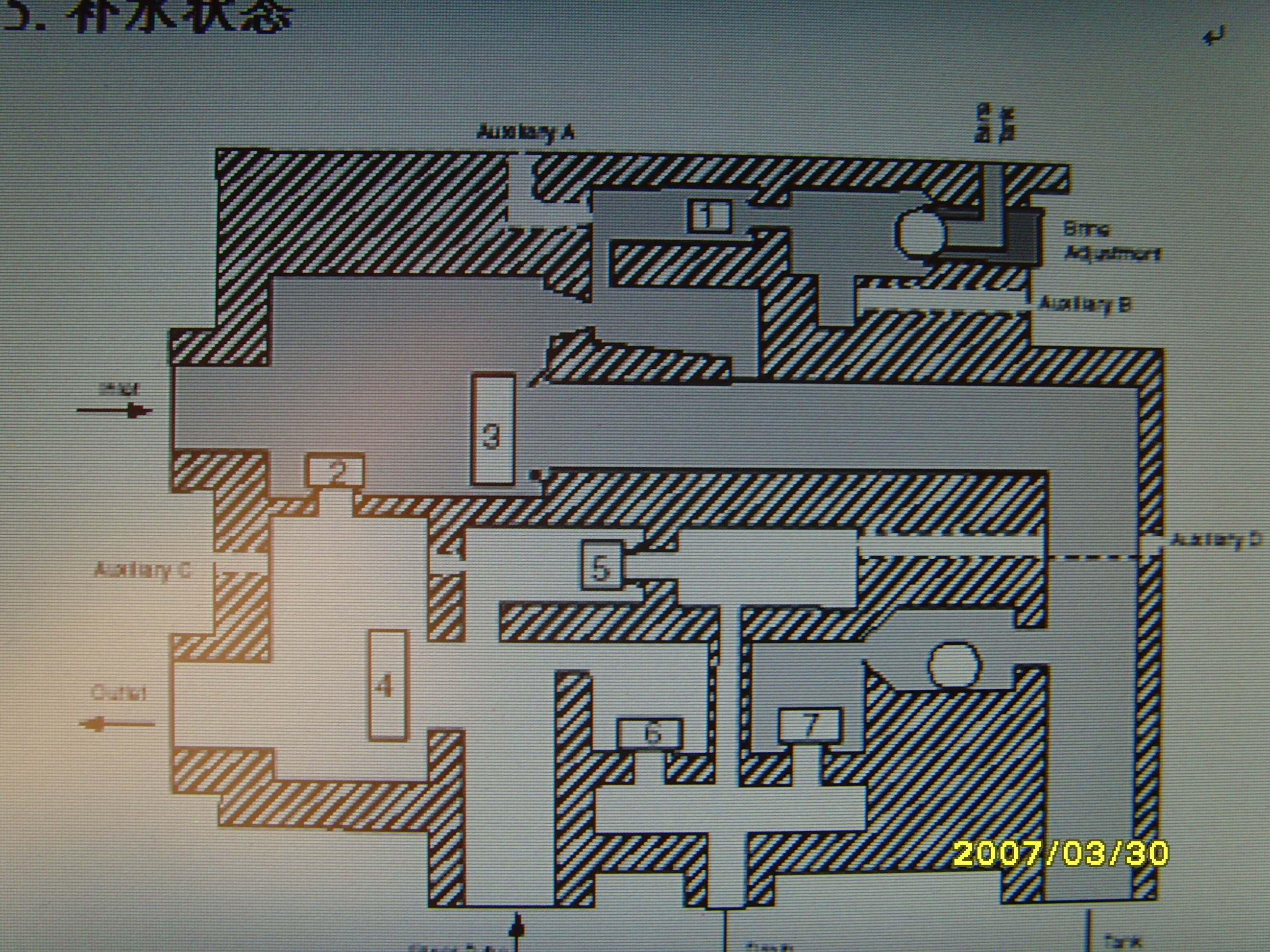

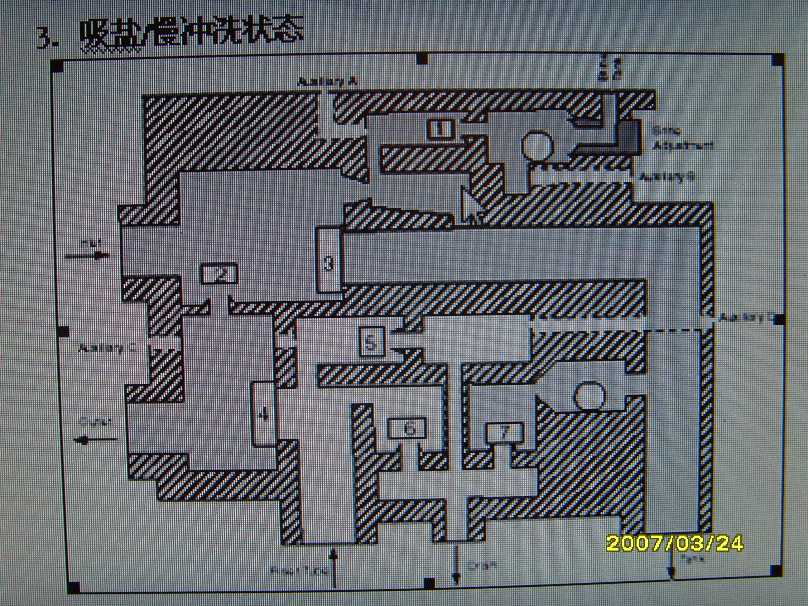

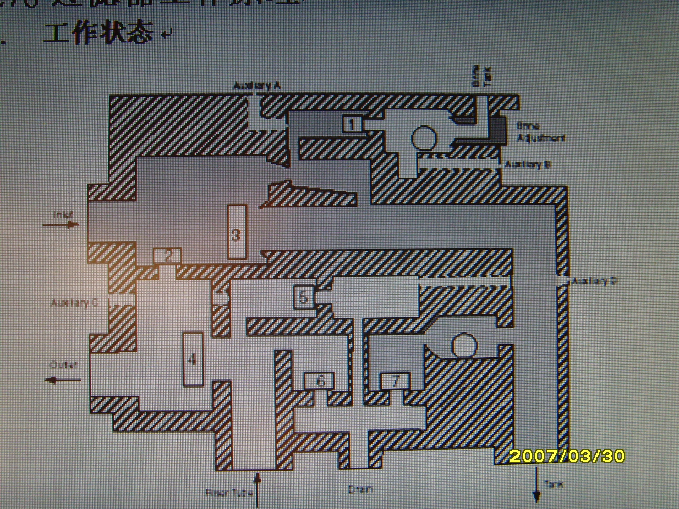

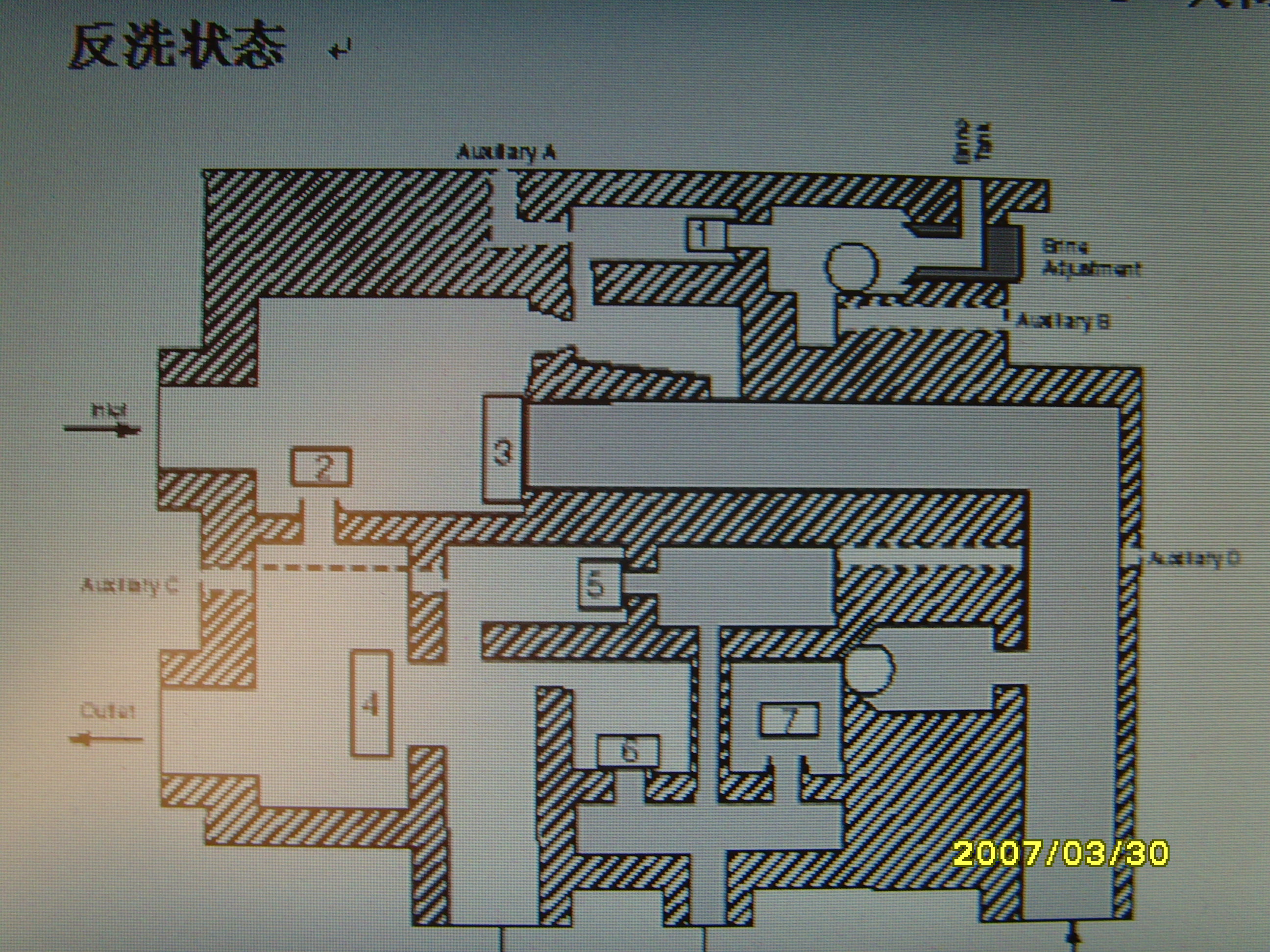

发表于 2007-3-30 16:07 | 显示全部楼层
278 阀体单罐工作原理
1.工作状态         #1 = 关闭  #2 = 关闭  #3 = 开启  #4 = 开启  #5 = 关闭  #6 = 关闭  #7 = 关闭
2.反洗状态         #1 = 关闭  #2 = 开启  #3 = 关闭  #4 = 开启  #5 = 关闭  #6 = 关闭  #7 = 开启
3.吸盐/慢冲洗状态  #1 = 开启  #2 = 开启  #3 = 关闭  #4 = 关闭  #5 = 开启  #6 = 开启  #7 = 关闭
4.  快冲洗状态     #1 = 关闭  #2 = 开启  #3 = 开启  #4 = 关闭  #5 = 开启  #6 = 开启  #7 = 关闭
5. 补水状态        #1 = 开启  #2 = 关闭  #3 = 开启  #4 = 开启  #5 = 关闭  #6 = 关闭  #7 = 关闭
278 /964阀体双罐一用一备工作原理
2.反洗状态         #1 = 关闭  #2 =关闭  #3 = 关闭  #4 = 开启  #5 = 关闭  #6 = 关闭  #7 = 开启
3.吸盐/慢冲洗状态  #1 = 开启  #2 = 关闭  #3 = 关闭  #4 = 关闭  #5 = 开启  #6 = 开启  #7 = 关闭
4.备用               #1 =关闭  #2 = 关闭  #3 = 关闭  #4 = 关闭(出水)  #5 = 关闭 #6 = 关闭  #7 = 关闭
5.快冲洗状态     #1 = 关闭  #2 = 关闭  #3 = 开启  #4 = 关闭  #5 = 开启  #6 = 开启  #7 = 关闭
6.补水状态        #1 = 开启  #2 = 关闭  #3 = 开启  #4 = 开启  #5 = 关闭  #6 = 关闭  #7 = 关闭
在第4.备用时出水阀板“4#”是关闭不了的,这你可以从图中看出的
