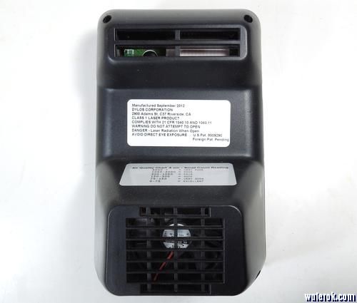

I bought the Dylos pro. That unit displays two counts. The first count is for particles 0.5 to 2.5 microns in size per 0.01 cubic foot,
: n, g; p) W8 h8 Z2 v* o2 E  k6 c% K. d3 f( u8 p8 W/ c! ~, R
the second is for particles larger than 2.5 microns per 0.01 cubic foot. It cost $300- `# A3 Z' V1 @) Y$ |3 ^
It's not as sensitive as professional particle counters, which can detect down to 0.3 micron.! S& J/ p  _" h& a
It's a fairly light-weight thing made mostly out of plastic. Where "proper" particle counters use some sort of pump to pump a
  I8 m8 F' {) Z3 q: _6 p. C  ?9 z  G4 x* l. j/ l( c
controlled volume past the detector, the Dylos just uses a small CPU fan in the back of the case.
9 y& J: d0 q6 ?It says "WARNING DO NOT ATTEMPT TO OPEN" on the back, but that never stopped me from looking inside...( e, ?: L3 {) S! Y6 ?! U

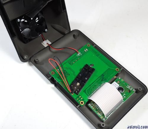

Here's the unit, popped open. The fan is attached to the back of the case. The black thing on the green circuit board is a piece of - t) g6 C5 u/ F' b7 O/ ^
" |. W. u$ E$ Q  T1 t8 Vplastic for holding the laser. I think its main purpose is to prevent diffracted light from the laser beam's aperture from getting to
  g. Z" l# [- \' U! q" Q/ h
3 v! |" o0 |( d- v3 `the detector.

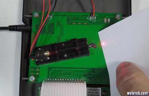

Plugged in, holding a piece of paper in the laser's path.8 z( R  N, X& }5 \+ Z' F
The laser is about as bright as a laser pointer laser. The small component between the piece of paper and the black thing that 7 m! D/ ~& e' V3 n* W" k, X
! Q9 c9 S5 X8 p  C* T
mounts the laser is a photo detector of sorts. The laser is focused to have the narrowest part of its beam right above the photo
7 A* E+ L+ d- G+ O/ r% l/ s& ]+ E9 z4 z4 d2 b$ K7 c/ i
detector.- ?/ d2 L1 F- F% D& M2 `( }# o

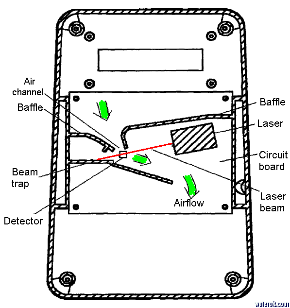

$ ?. \8 v5 u3 P- HI looked up the patent number on the back of the unit, and found it here: US patent 8009290- D3 R& K* [  N/ c) n- ^& T
I re-label;ed one of the drawings from the patent. The arrows, highlighted in green, show the direction of air flow.
1 s2 o) h- b. S9 U0 ZDust particles passing through the laser beam above the detector will deflect some of the light onto the detector. Larger particles ' H4 C# k. |* z, b9 h$ Z
6 n$ R9 I' `+ [) M8 u2 z! nwill scatter more light, so particle size is gauged by the intensity of the pulse of light on the detector.& _+ Q- q. ?7 ]! a, Y% o, M1 o

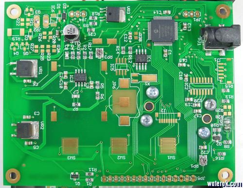

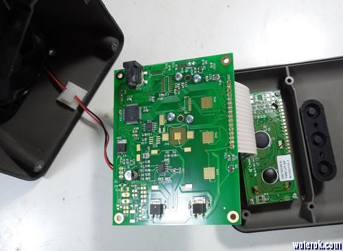

Unscrewing the main circuit board reveals the circuitry behind it. A micro controller, some analog components, and the pads for
( L/ T/ p- p9 }; E! X: o. x4 r/ w  L% {" W, w  F" L
the three buttons.- f$ r) E3 d; N% s& X
6 d' V9 j: c: C! w1 R. v
: ~* `1 w4 C( `$ P, W# e$ F. W
A close up of the main circuit board, for those who are curious as to what the chip part numbers are (click to enlarge)

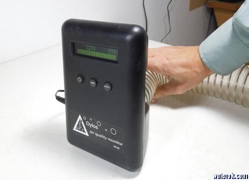

With just a CPU fan providing the air flow, the meter is not suitable for sampling fast moving streams of air. Obstructing the air
7 O" U, |2 Q) V6 q% _. }  g( A/ k: S& H- y/ l7 L
flow makes the counts go down, and increasing it makes it go up. Here I'm using my dust collector to pull more air through the
' u5 N0 v9 @# G0 m2 u) c2 a3 N: B
, p' c; X7 u- x0 Lunit than normal. Doing so tripled the readings on the meter. So varying the air flow rate can definitely change the readings. The 4 Z# y, X8 G: K+ s/ T. _! I! E5 c  A! n
/ I& O% s$ \4 Ppatent makes claims about gauging the air flow rate by the pulse width from the particles, but either the Dylos software does not # ?$ ^2 `( w' {% Z- X% V
( i. U. N) |7 n8 c' s
implement this feature, or it adjusts very slowly.0 T  r# ~. i+ C5 @. L& j

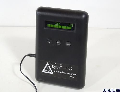

The nice thing about this meter is that it gives a numerical reading within about ten seconds of powering it up, so it's good for
6 K& j' J1 E& o7 {- g* a7 c4 B: G0 m; O* ^( Y
comparative purposes. I used a fan to blow air through my washable reusable furnace filter (on the floor in this photo) and
. }$ {, L6 |, J+ M
3 e' P  Q* z( r, aholding the meter on the other side of that filter, found the readings were the same as for the room air. So the filter really wasn't
& O1 o( p# u9 I* {/ o, }4 x* h$ T
: j6 h& o% h7 x% K: o2 @$ `9 Jcapturing any of the fine dust.

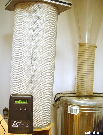

! Z( U' F# V  c4 \" n0 Y, jEven though the microparticle filter in my dust collector performed disappointingly, I bought another one of these fancy filters to try in my furnace. Blowing air through it with a fan, I found that it caught most of the fine stuff. And once I installed it in my furnace, I found the particle counts in my house went down significantly.9 h7 v4 \3 _% _% o1 P. _
In fact, with the Dylos set to "monitor mode", I could see both the fine (0.5 to 2.5 micron) and coarse (2.5 micron and up) particle counts decrease every morning when the furnace came on to warm up the house.' G5 b+ M, h9 O5 }" |- t
So these microparticle filters really do work, at least when they are relatively new and used as intended.

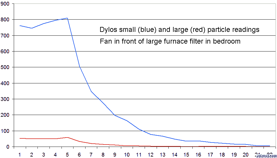

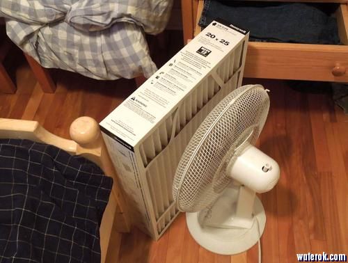

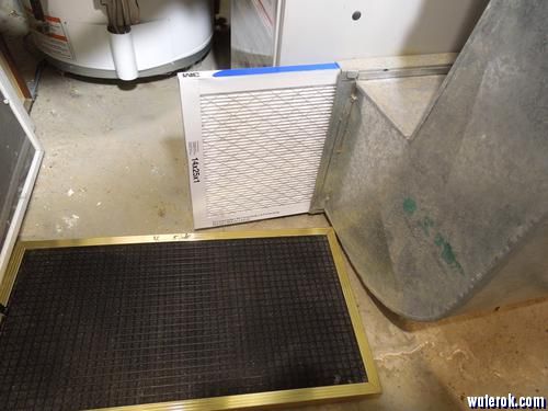

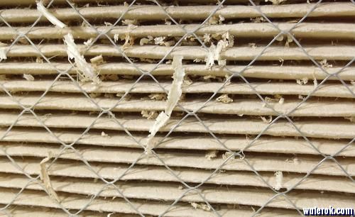

For experimenting, I also bought the biggest furnace filter cartridge I could find. I found that just blowing air through it with a regular fan really cut down on the particle counts in the room. After about 15 minutes like this in my bedroom, the particle count dropped from around 800 and 60 (small and large particles) to 15 and 0.
( O1 O6 n8 [) j, ]$ M
4 I: a# T' C  N4 KAt $30, this filter is still much cheaper than the cheapest air cleaner. So if you suspect that an air cleaner could help you with allergy problems, buy one of these big furnace filters and put it in front of a fan, just as an experiment.
* K2 `. Y9 P& ~% x$ \I don't know how well these furnace filters work over time compared to HEPA filters in most air cleaners, but when they are new, just blowing air through them like that really works!! ?- ~2 {9 _1 c3 N' g& N) t
. a) L/ V% `1 {7 E% U dylos10.jpg 8 m+ ?7 P4 m- d3 y

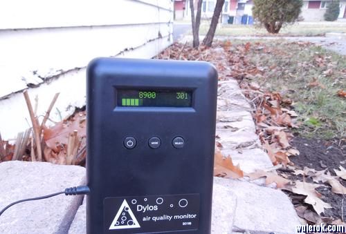

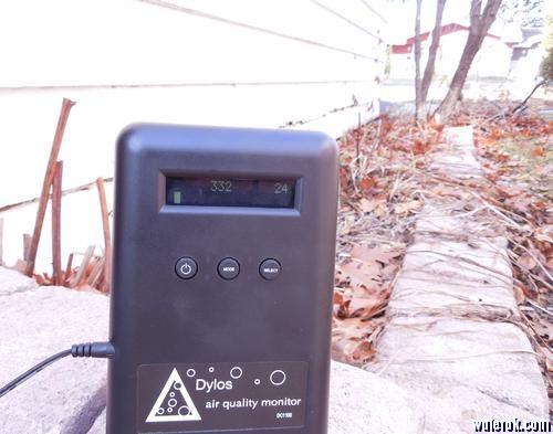

With my new furnace filter, typical readings indoors are about 300 of the 0.5 to 2.5 micron particles. But I found day to day readings varied quite a lot. A big source of variations, it turns out, was outside air. On some days, the outside air read at about 9000 microparticles...9 l" P% y" g# `9 X# w2 H
0 e( k5 L5 b# s0 G
+ s+ a$ P: \( A3 B... but sometimes, it was as low as 300. It all depends on wind, rain and recent precipitation.
4 x, }; K+ v6 h+ ?
' X; j% c( V# r& V
$ ^5 [; f$ y4 n' y2 n' PThe Dylos confirmed that the air coming out of my small dust collector wasn't terribly clean, giving typical readings of around 2000 and 600. The microparticle filter, used this way just doesn't work that well. Although a particle count of 2000 is not that bad while running machines. Typical indoor air is often around 1000, and workshop air, when using power tools, is usually higher.

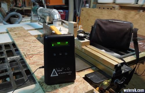

. W9 Q9 L0 a3 `+ DI revisited my friend Bill Price's workshopto sample his dust collectors.: {- T4 d/ X5 m- {% x
He has some box fans, with cheap furnace filters in front of them in his garage workshop where he does wood turning. In front of the furnace filters, he has pieces of paper towel to catch some of the coarse dust. The particle count in his garage was more on the high side.( v4 z) n- P4 f2 q- C0 I
He also has a cheap Mastercraft dust collector from Canadian Tire, so we powered it up to see if it made a difference.

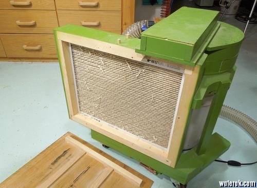

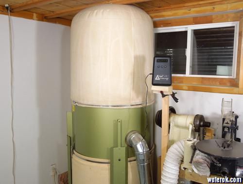

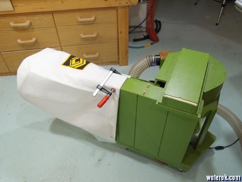

So bought a small replacement filter bag from Busy Bee tools, the same style as on Bill's better dust collector. This bag is supposed to filter to about 1 micron. The bag is made of some felt-like material.  X# }1 X: B  r0 T: F
As far as I can tell, it doesn't work as well as advertised but blowing air through it does reduce the small particle counts. So for the time being, I stuck it over the air outlet on my small dust collector, fixed in place with a clamp. The air coming out the filter bag reads about 300 particles, so the bag catches a lot that the furnace filter doesn't catch.5 W3 q' D3 o- m! h& S5 W- D$ k
The filter bag only cost about $26. Had I known what I know now, I would have designed my dust collector to use one of these in the first place. Or maybe I should try to make a pleated filter from that bag.3 ^$ }, @6 ]. f6 g# k  f
) i/ h) ?/ s; M; \

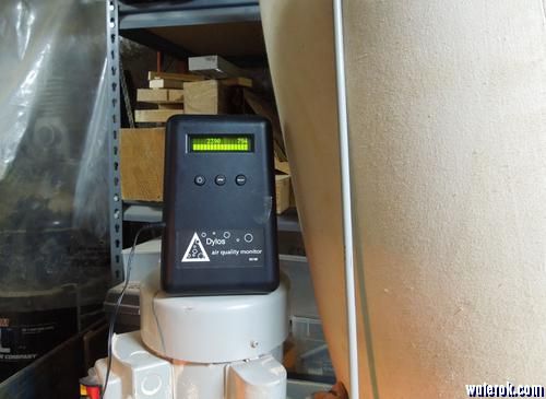

: U( G6 e. ?4 G2 Z! q# y2 ]I wasn't expecting my big dust collector to perform terribly well. The fitter bag on it is just covered with dust, and if I run my hands along the inflated bag, I can see a cloud of dust released from it.- \8 A+ |2 z# S& U; f1 W
When I start it, it also releases a cloud of dust as the bag inflates. But once it's running for a minute, the readings on the Dylos really drop. After about four minutes, the Dylos, right next to it, will read counts below 50! But if I as much as stroke my hand across the filter bag while it's running, the counts go up immediately.
- c2 b" E& n7 x- S  EStill, with a storm of dust going on inside that bag, the air coming out of it has a much lower particle count than outside air.
0 ^# ~0 u& |$ ^) V# v. q: r% L8 M/ _8 K
Makes you wonder whether venting your dust collector to the outside, as Bill Pentz suggests, is always a good idea.[/url]3 M( k' M4 _/ T8 y  P- V

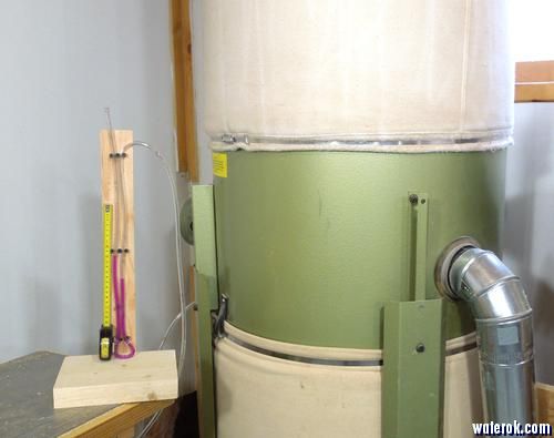

Most filters get more "efficient" at filtering out dust particles over time, a process that is referred to as a filter getting "seasoned".
; p; Q: t5 ^' P/ e" [3 e# m' f" q/ s/ u! z- v8 H
A filter isn't really like a sieve, more like a tangle of fine fibers that particles get caught in. As all the largest pathways through the fibers get plugged up with larger particles, only smaller pathways remain, which in turn trap more of the particles.8 E5 p! y; h+ w( X( q; Q6 Q5 Q6 G
"Efficient" is a relative term though, because as the filter's air pathways become smaller, it develops more air resistance. So for the same airflow, the filter will produce increasing amounts of back-pressure.4 Q- c8 v. J( F. v$ T
I measured the pressure inside my dust collector at 45 mm water. Definitely higher than any other air filter I have, but then again, still much less back-pressure than the cyclone aloneon my homemade small dust collector. Given that this filter does not need a cyclone upstream, 45 mm of back-pressure is not bad.

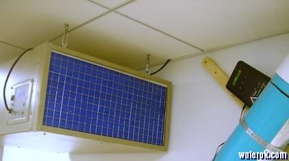

Daniel also tested it next to his JDS air cleaner. The blue filter is the output side of the air cleaner. After five minutes of running, the Dylos was reading 140 and 16. With the air cleaner turned off, it then settled back to around 250 and 40.
; P/ D2 K; n3 S, l2 [. F# Y+ `

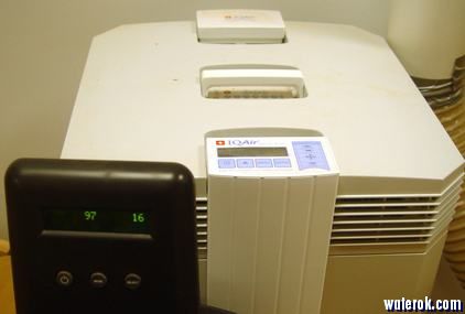

/ c0 d7 H6 d: ]% c; MDaniel also has a IQAir HEPA air cleaner. After five minutes of running, the Dylos read 92 and 17. Daniel says "From experience if I let the HEPA cleaner run for hours I can get the particle count even lower, usually around 15 and 0".
; z  ?$ Q( |2 j: E# m; N  l. V
